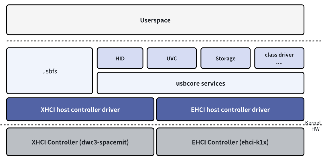

USB Host
The USB Host role driver framework can be divided into the following layers:
  • USB Host Controller Driver: This is the USB controller driver layer, responsible for initializing the controller and performing low-level data transmission and reception operations.
  • USB Core Services: This is the core layer, responsible for abstracting the USB hierarchy and URB-based transfers, and providing interfaces for upper and lower layers.
  • USB Class Driver: This is the USB device functionality layer, responsible for implementing USB device drivers, USB function drivers, and interfacing with other kernel frameworks (such as HID, UVC, Storage, etc.).

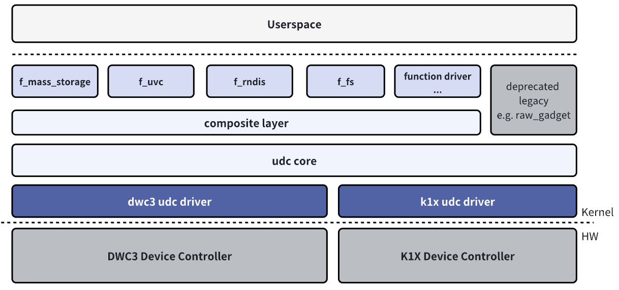

USB Device
The USB Device role driver framework can be divided into the following layers:
  • USB Device Controller Driver: This is the USB Device role controller driver layer, responsible for initializing the controller and performing low-level data transmission and reception operations.
  • UDC Core: This is the core layer, responsible for abstracting the USB Device hierarchy and URB-based transfers, and providing interfaces for upper and lower layers.
  • Composite: Used to combine multiple USB Device functions into a single device, supporting configuration by userspace through configfs or hard-coded combinations of Functions in legacy drivers.
  • Function Driver: This is the USB Device functionality layer, responsible for implementing the functional drivers for USB Device mode, and interfacing with other kernel frameworks (such as storage, V4L2, networking, etc.).
These layers together form the framework of the USB subsystem in the Linux system, ensuring the normal operation and data transfer within the USB module system.
