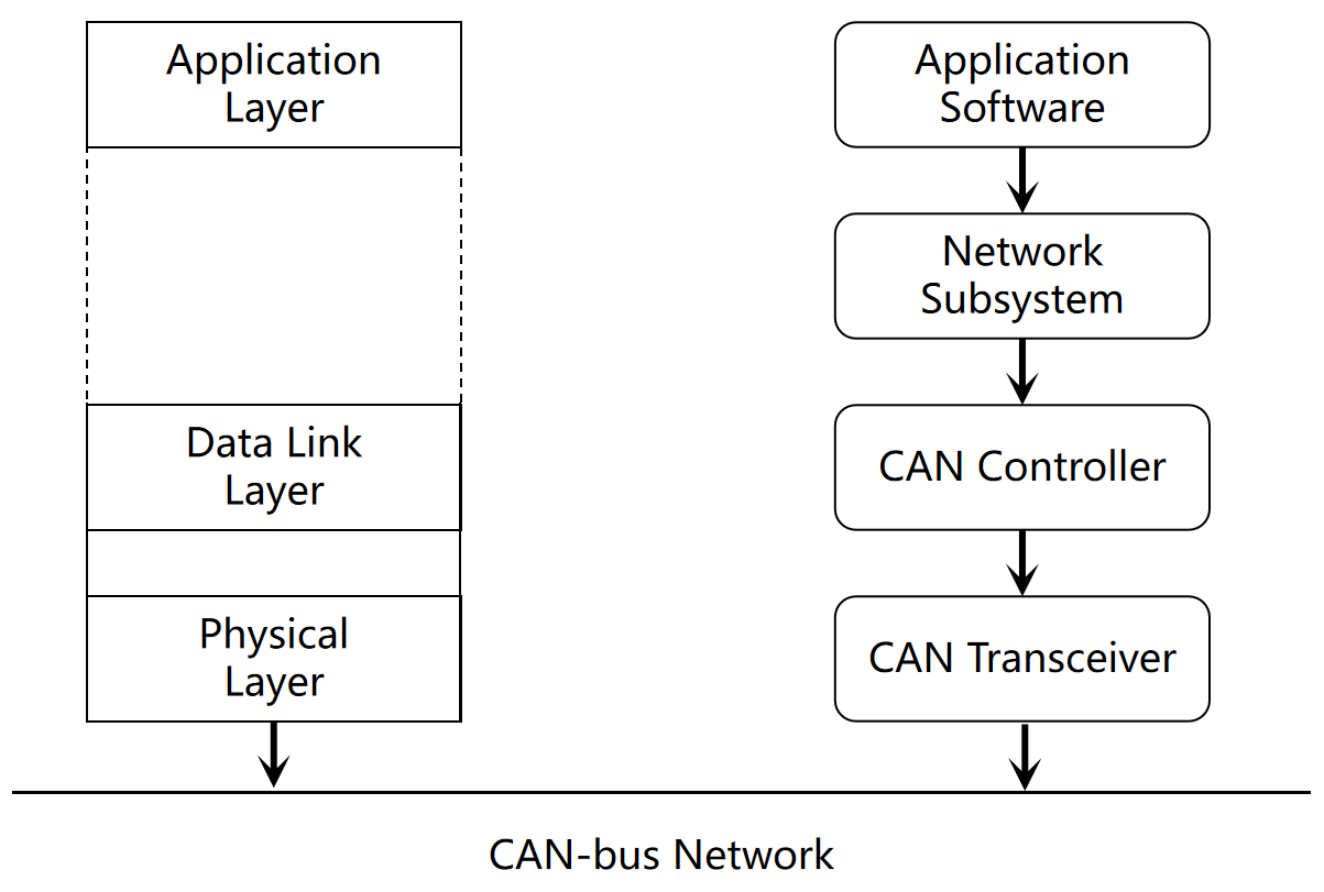

The CAN controller supports message transmission and reception compliant with CAN 2.0 and CAN FD protocols, handling standard data frames, remote frames, and extended data frames, etc. The CAN driver registers as a network device through the network device interface. In the user layer, CAN driver calls can be made to achieve message transmission and reception using specified network tools or interfaces.

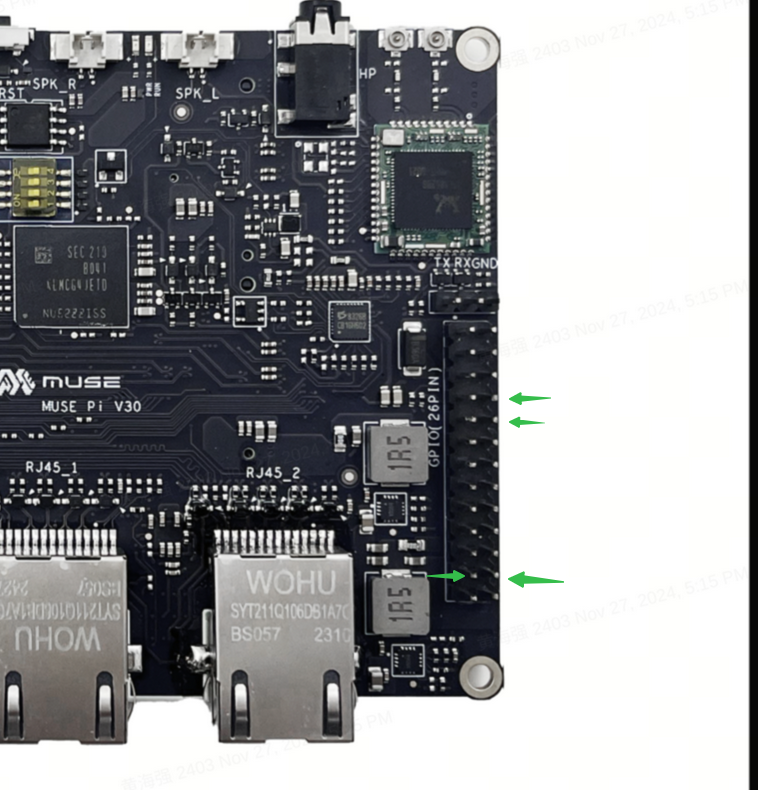

    The pin directions are indicated by the green arrows from top to bottom as shown in the figure above, which are as follows:
    1. rcan tx: gpio47, pin 8 of the 26-pin interface
    2. rcan rx: gpio48, pin 10 of the 26-pin interface
    3. can0 tx: gpio75, pin 23 of the 26-pin interface
    4. can0 rx: gpio76, pin 24 of the 26-pin interface

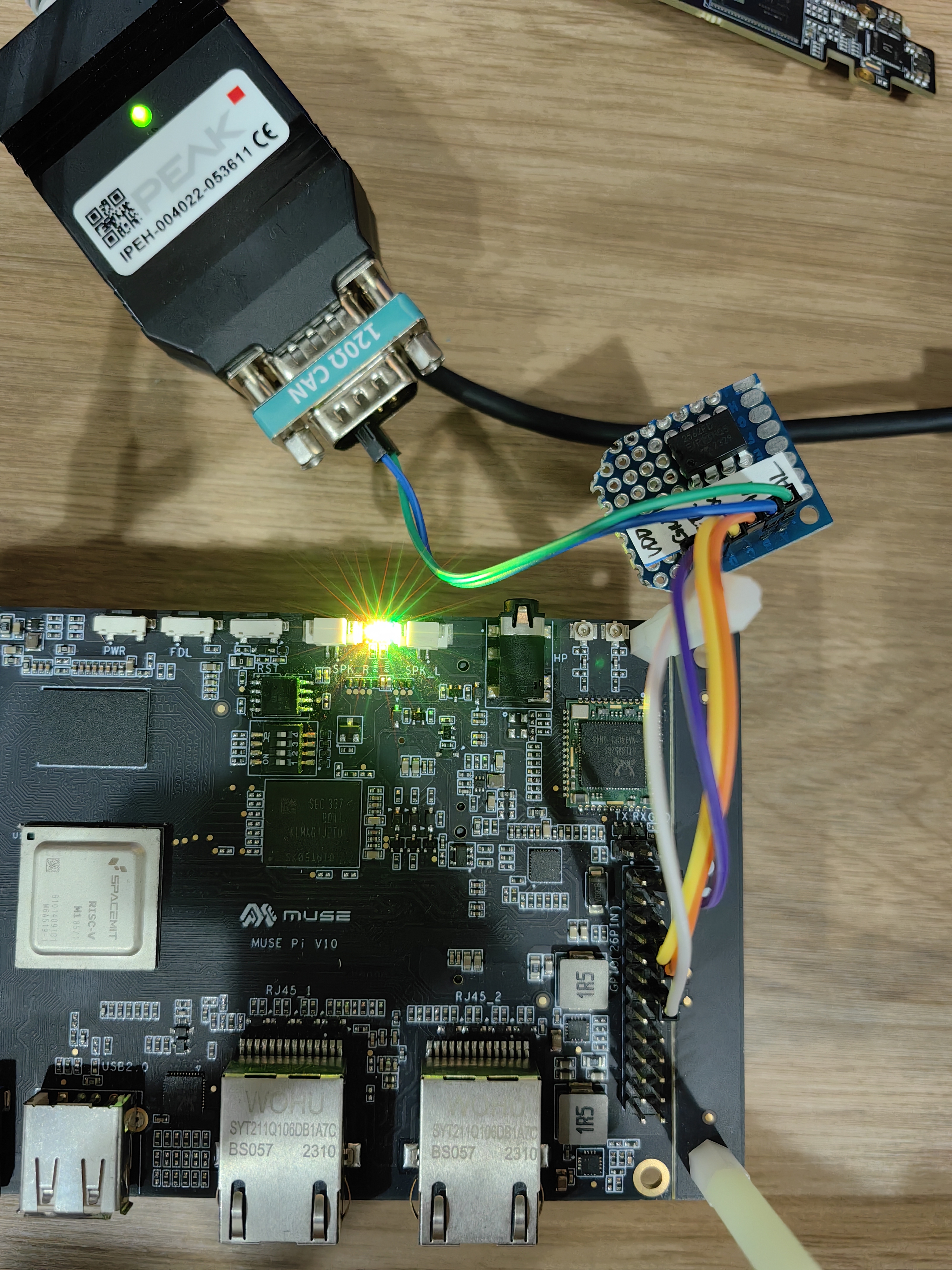

  • Install CAN software on the PC and connect a PC CAN device (you can connect two CAN peripherals for mutual transmission and reception). In this example, we use PEAK's PCAN, which can be found on the PEAK official website. The wiring for rcan is shown in the figure below, and the wiring for can0 is similar.
    alt text
