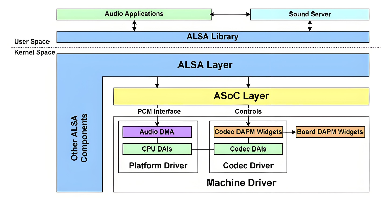

The ALSA audio framework can be divided into several layers:
  • ALSA Library
    Provides a unified API interface to applications. Various applications can achieve playback, recording, and control by calling the APIs provided by the ALSA library. Two basic libraries are currently provided: tinyalsa, which is a simplified version of the ALSA library, is mainly used in Android systems.
  • ALSA CORE
    The core layer of ALSA, which provides logical devices (PCM, CTL, MIDI, TIMER, etc.) for system calls and drives hardware devices (Machine, I2S, DMA, CODEC).
  • ASoC Core
    The standard framework of ALSA, which is the core part of the ALSA-driver. It provides general methods and data structures for various audio device drivers.
  • Hardware Driver
    The audio hardware device driver, which consists of three main parts: Machine, Platform, and Codec. It provides the ALSA Driver API and the initialization and workflow of the corresponding audio devices, implementing specific functional components. This is the part that driver developers need to implement specifically.
  • Machine
    Typically refers to a specific single board that includes particular peripherals, providing a carrier for the CPU and Codec. Machine drivers are almost non-reusable. The Machine driver links the Platform driver and the Codec driver together, specifying which Platform driver to use, which SoC-side DAI (Digital Audio Interface) to use, which Codec driver to use, and which DAI interface on the Codec to use, while also performing operations specific to the single board.
  • Platform
    Generally refers to a specific SoC platform, which can be understood as a particular SoC with I2S, AC97 audio interfaces, internal clocks, and DMA units for audio data transfer. The Platform driver is only related to a specific SoC, implementing the SoC's audio DMA driver and the DAI interface driver on the SoC side. It is only related to the SoC and not to the Machine, allowing the Platform to be abstracted out so that the same SoC can be used in different Machines without any modifications.
  • Codec
    The audio codec, which includes I2S interfaces, D/A, A/D, Mixer, and PA (Power Amplifier). It typically contains multiple inputs (Mic, Line-in, I2S, PCM) and several outputs (headphones, speakers, earpiece, Line-out). The SoC usually controls the codec chip via I2C. The Codec driver is only related to the Codec and is independent of the SoC and Machine. Like the Platform, the Codec should be implemented as a reusable component, allowing the same Codec to be used in different Machines.
