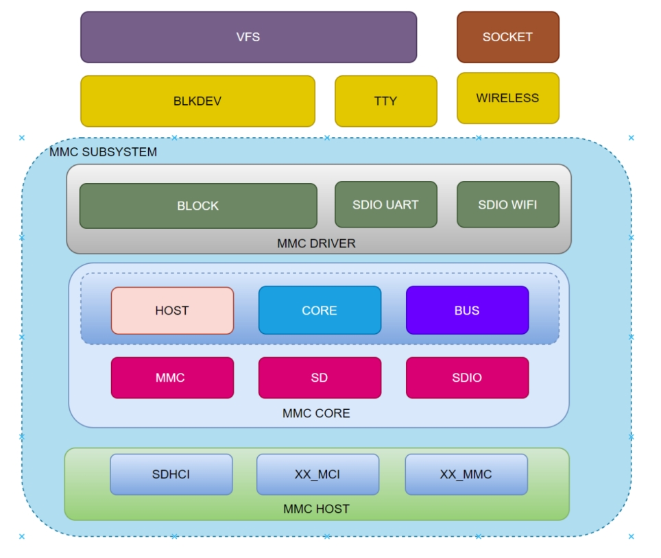

The MMC subsystem comprises three layers:
  • MMC Host: This is the MMC controller driver layer, responsible for initializing the MMC controller and handling low-level data transmission and reception operations, directly controlling the underlying registers.
  • MMC Core: This is the core layer, responsible for abstracting virtual card devices and providing interfaces for upper layers to use.
  • MMC Block: This is the block device layer, responsible for implementing the block device driver program and interfacing with other kernel frameworks (such as block devices, TTY, wifi, etc.).
These layers together form the complete framework of the MMC subsystem in the Linux system, ensuring the normal operation and data transmission of MMC devices in the system.
