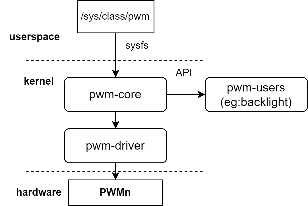

The kernel’s PWM framework enables modules to request PWM controllers and manage signal output.
For example, fan speed control and backlight brightness in the kernel can both be controlled using PWM.
Source Code Structure
The PWM controller driver code is located in the drivers/pwm directory:
drivers/pwm
|--core.c # Kernel PWM framework interface code
|--pwm-sysfs.c # Code for registering the PWM framework to sysfs
|--pwm-pxa.c # K1 PWM driver
