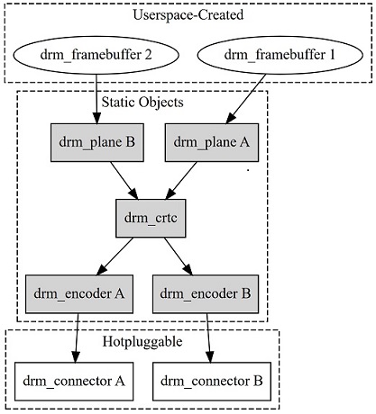

The Display module on the SpacemiT platform is implemented based on the DRM (Direct Rendering Manager) framework.
DRM is a mainstream display framework in the Linux system, well-suited to modern display hardware features.
In the Linux kernel, DRM acts as a subsystem for managing display devices, mainly responsible for the following tasks:
  • Display hardware abstraction and management: Unified management of different types of display hardware.
  • Graphics memory management: Allocation and control of video memory usage.
  • Display output control: Coordination of composition and output of display content.
  • Multi-display interface support: Compatibility with multiple interfaces such as HDMI, DSI, eDP.
display-kms
