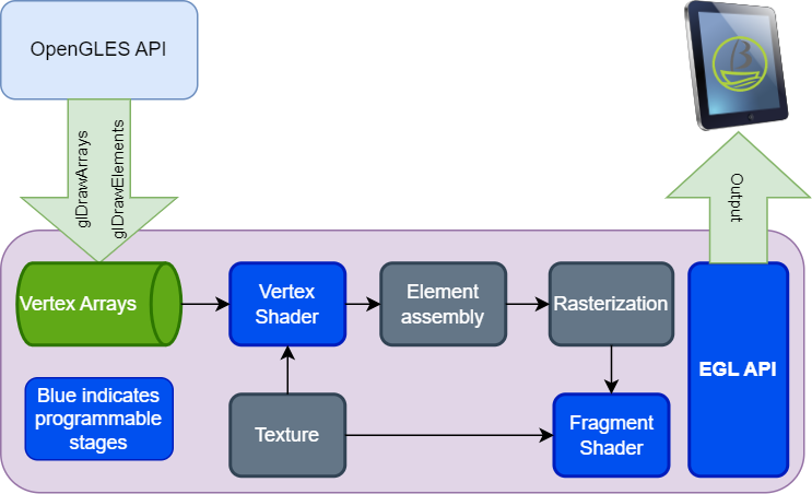

In the cooperation between OpenGL ES and EGL, the rendering process is the core of the entire graphics rendering system.
The diagram below shows the basic OpenGL ES rendering process.
mesa3d
The rendering process typically involves five main steps:

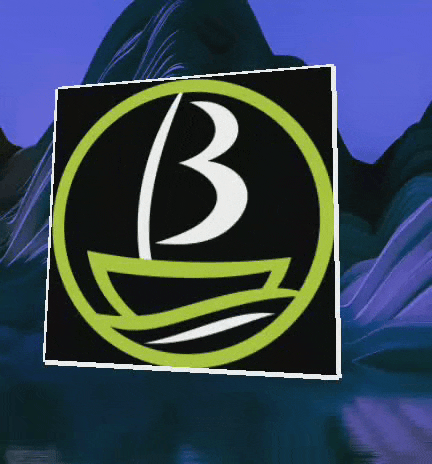

  4. Runtime effect
    After successful execution, the rendered output is shown below:
    gpu-cubeTextureDemo
