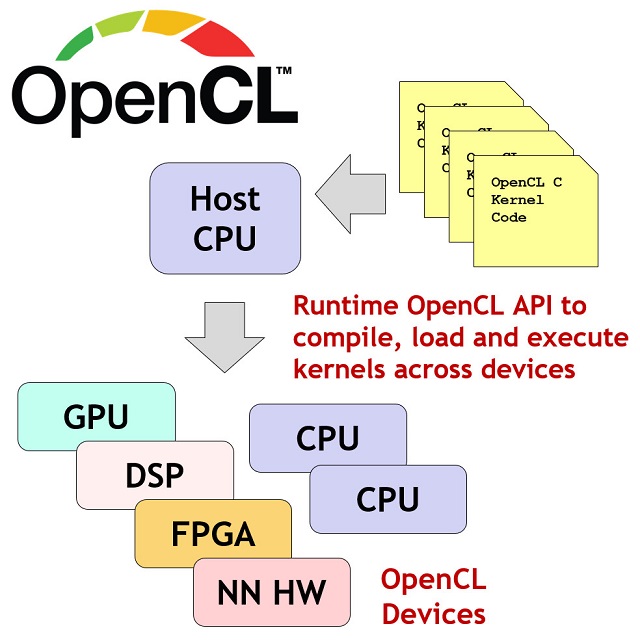

opencl
As shown in the figure, the OpenCL framework contains two critical API layers:
  • Platform Layer API
    Runs on the host (Host) CPU
    Main functions:
    • Query and enable the parallel processors or compute devices available in the system
    • Allow the application to be ported and executed across different systems, supporting a variety of hardware combinations
  • Runtime API
    Core functions:
    • Compile kernel programs for the selected device
    • Manage the parallel execution of kernels on the processor
    • Collect and process the computation results

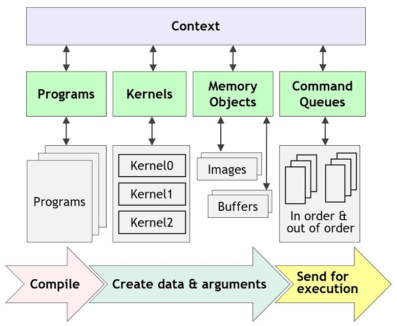

The figure below illustrates the flow of executing an OpenCL kernel:
opencl
The complete steps for executing an OpenCL program are as follows:
  1. Query the available OpenCL platforms and devices
  2. Create a context for the OpenCL devices in one or more platforms
  3. Create and build a program for the devices in the context
  4. Select the kernel(s) to be executed from the program
  5. Create memory objects for the kernel to operate on
  6. Create command queues to issue commands to the OpenCL device
  7. Retrieve the execution results and clean up the environment
