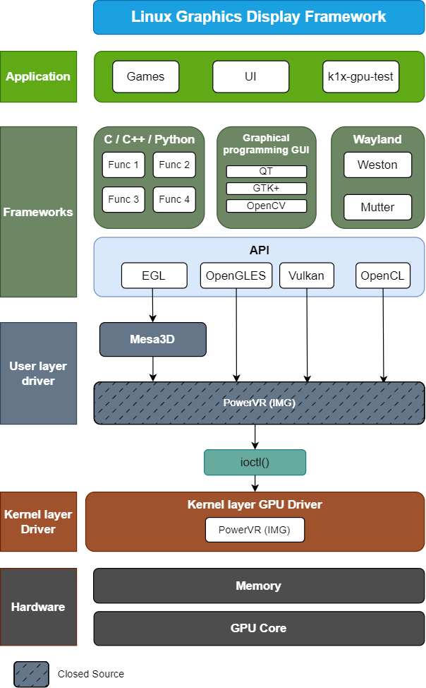

Graphics Driver Framework
Overall Framework
Linux Graphical Framework
