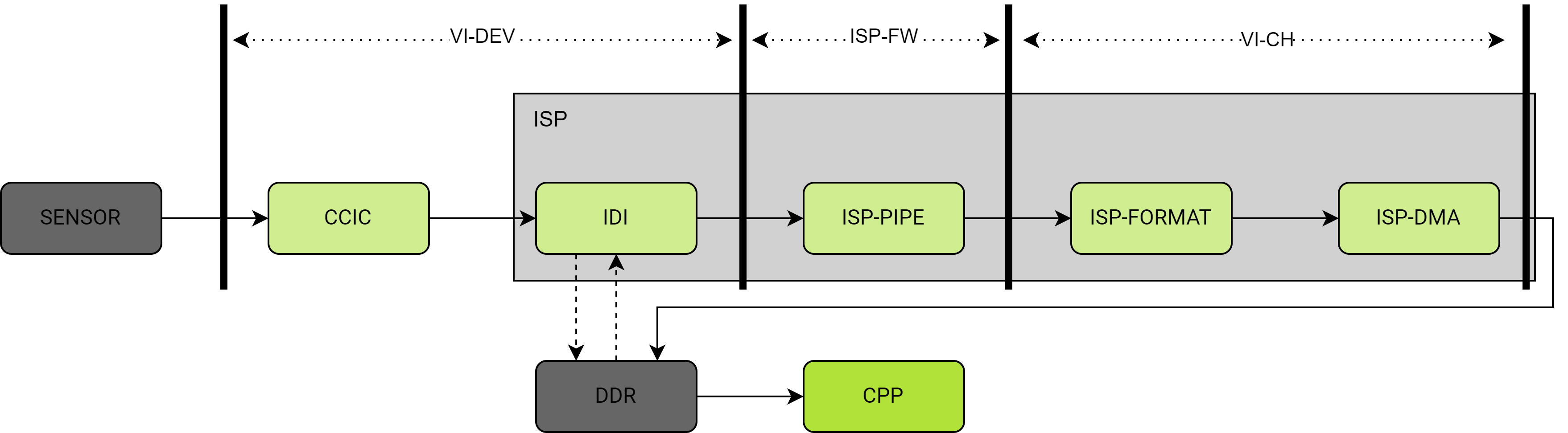

Description of Core Functional Modules:
  1. SENSOR (Image Sensor)
    • Converts light from the lens into electrical signals, then uses internal AD conversion to generate digital signals, and finally outputs MIPI RAW data.
  2. CCIC (CMOS Camera Image Controller)
    • Parses and receives the MIPI data sent from the sensor.
  3. IDI (ISP Data Input Module)
    • Receives data from CCIC or reads data from DDR and sends it to the ISP Pipeline
    • Also stores CCIC data into DDR
  4. ISP-PIPE (Image Processing Pipeline)
    • Internal ISP hardware pipeline
    • Performs a series of image-related algorithm processing
  5. ISP-FORMAT (Output Format Control)
    • Internal ISP hardware module
    • Controls the output image format
  6. ISP-DMA (Direct Memory Access)
    • Writes image data into DDR
  7. CPP (Post-Processing Unit)
    • Performs image noise reduction and edge enhancement.
System Data Flow Description
Raw light signal → SENSOR (photoelectric conversion) → CCIC (data reception) → IDI (data routing) → ISP-PIPE (image processing) → ISP-FORMAT (format conversion) → ISP-DMA (memory write) → CPP (post-processing) → Final output

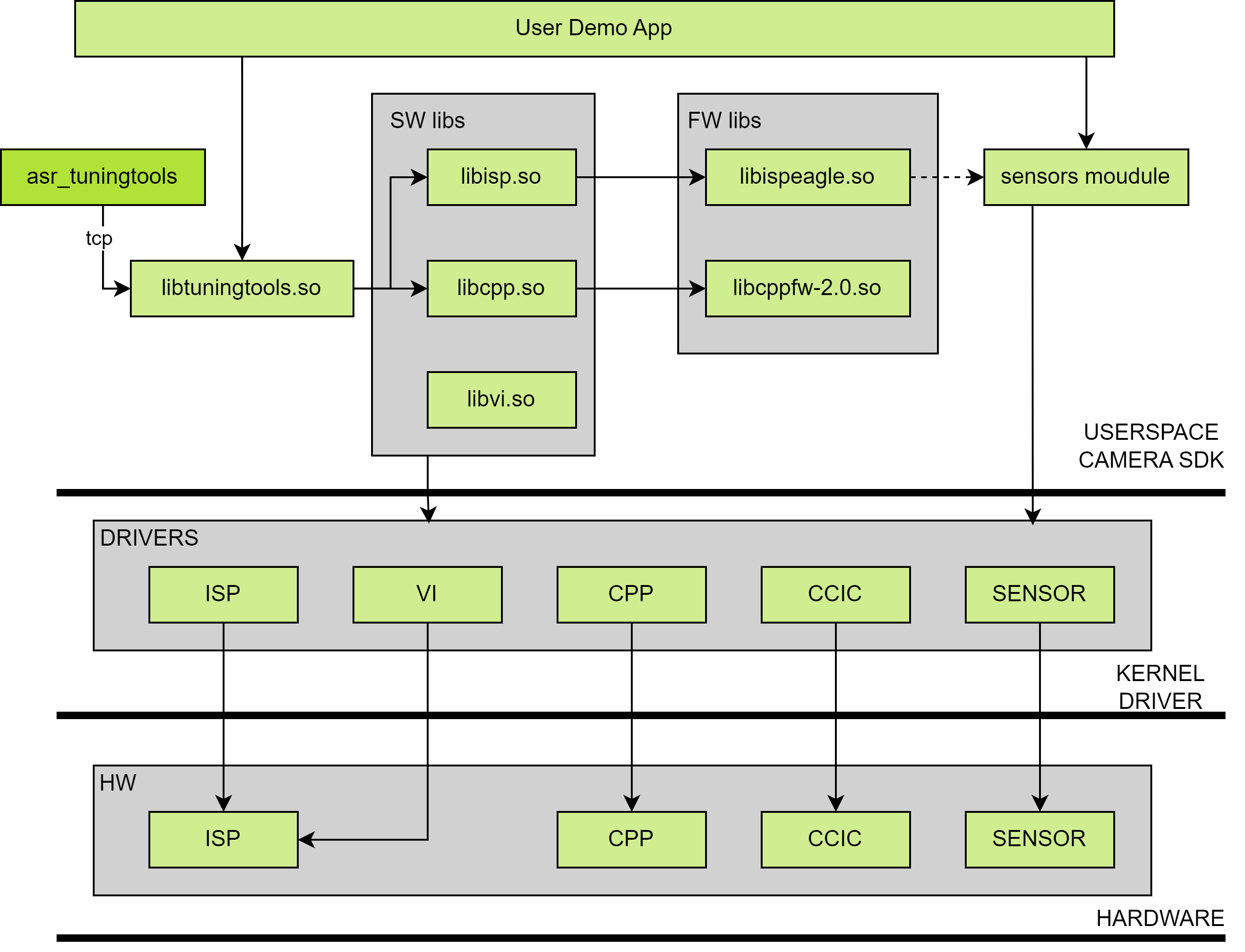

Camera Driver Framework
Note:
This section is for informational purposes only. During actual development, except for the sensor driver part, the rest of the content is typically not involved in the sensor bring-up process.
Framework Overview
The SpacemiT camera driver is implemented based on the Linux kernel V4L2 framework. Its main functionalities include:
  • Hardware register access
  • Interrupt handling
  • Buffer and event management
  • Providing SDK interfaces to user space
The relationships among the various modules within the Camera subsystem are shown in the diagram below:
Camera Subsystem Software Architecture
From a software call perspective, the architecture is divided into the following three layers from top to bottom:
  • Userspace: Runs in user space.
    • Includes ISP, CPP, VI, and tuning tools software libraries, firmware libraries for ISP and CPP, and sensor module source code.
    • Users primarily interact with camera applications by calling the interfaces of the ISP, CPP, VI, and sensor modules. Interfaces in the firmware libraries are called internally by the ISP and CPP software libraries.
    • Additionally, if users need to use ASR's tuning tool to adjust the image quality of ISP/CPP output, they must call the interfaces of libtuningtools.so in their application to create a tuning server.
  • Kernel Space:
    • Runs in kernel space.
    • Primarily provides drivers for ISP, CPP, VI, CCIC, and sensors.
  • Hardware Layer:
    • The hardware modules that are directly accessed by the drivers.
For sensor bring-up needs, the main focus should be on the APP demo implementation in userspace, i.e., how to call SDK interfaces to fulfill specific application scenarios.

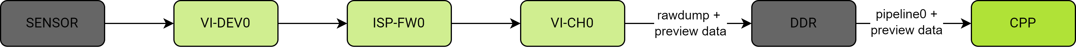

Case 1: single_pipeline_online_test
This case implements the single pipeline online image processing function. The image is processed sequentially by ISP and CPP, and supports the ISP rawdump feature.
In this case, ISP uses firmware0, CPP uses pipeline0, and VI work mode uses dev0 along with its associated physical and rawdump channels.
The data flow is shown below:
When configuring each module, pay attention to filling in the input and output information. The table below shows the details:
Table - case1 Input/Output
ModuleInputOutputNote
sensorNA1920x1080NA
ISP1920x10801920x1080,NV12_DWTCAM_ISP_CH_ID_PREVIEW
VI1920x10801920x1080CAM_VI_WORK_MODE_ONLINE
CPP1920x10801920x1080NA
Regarding buffer handling in this case, the following callbacks need special attention:
  • isp_buffer_callback: ISP frameInfo callback, invoked when the ISP firmware obtains the image frameInfo. Users can use this callback to get the online image frameInfo for specific operations.
  • vi_buffer_callback: VI physical channel buffer callback, called after the VI user layer obtains the ISP processed buffer. Since ISP has a downstream module CPP, this callback should forward the output buffer to the CPP module as input (achieved by calling cpp_post_buffer).
  • vi_rawdump_buffer_callback: Called when the VI user layer receives ISP rawdump data. Users can perform operations such as saving rawdump data in this callback.
  • cpp_buffer_callback: CPP buffer callback. For CPP input buffers, this callback should return the buffer back to the resource pool to be reused as ISP output buffer. For CPP output buffers, users can obtain the processed results from the buffer.

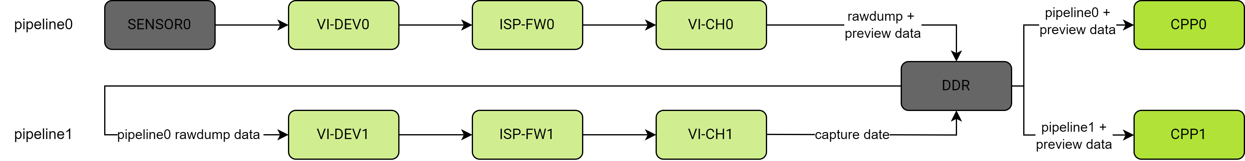

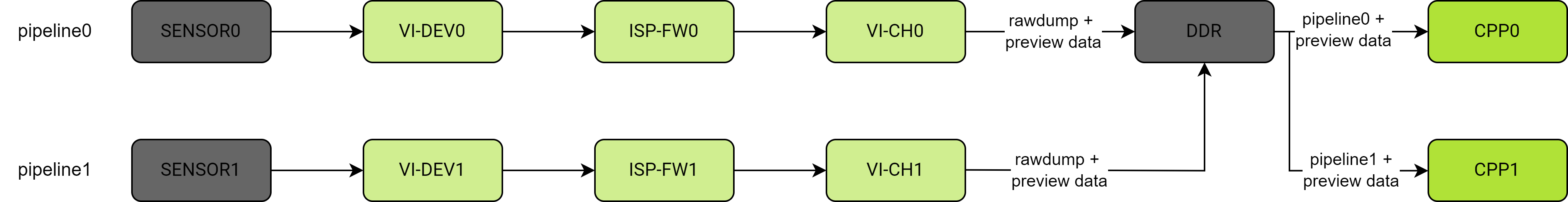

Case 2: dual_pipeline_online_test
This case implements the dual pipeline online processing function. On top of the pipeline0 from single_pipeline_online_test, it adds processing for pipeline1. The data flow is shown below:
Except that the sensor data comes from two different physical devices, the software processing for both pipelines is exactly the same. That is, Sensor, ISP, VI, and CPP are all configured in duplicate according to the pipeline.
For the first pipeline:
  • ISP uses firmware0
  • CPP uses pipeline0
  • VI uses DEV0 and its associated channels
For the second pipeline:

Case 3: dual_pipeline_capture_test
In this case, ISP pipeline0 operates in online mode, while ISP pipeline1 operates in offline mode. The rawdump result from ISP pipeline0 serves as the input data for ISP pipeline1. After executing the ASR_ISP_TriggerRawCapture operation, the capture function is realized. The data flow is shown below:
Compared to the previous two cases, note that the pipeline1 workflow is slightly different.
  • The VI module of pipeline1 uses DEV1’s bayerRead channel to read pipeline0’s rawdump results from DDR, and uses the physical channel to output capture results to DDR, while pipeline1’s rawdump channel is inactive.
  • Accordingly, the callback handling of both pipelines changes as follows:
    • vi_buffer_callback: VI PHYSICAL channel buffer callback for pipeline0 and pipeline1. Similar to the first two cases, mainly responsible for passing output buffers to their respective CPP modules as input (implemented via cpp_post_buffer).
    • isp_buffer_callback: ISP frameInfo callback for pipeline0. Same as the first two cases.
    • vi_rawdump_buffer_callback: Rawdump callback for pipeline0. In addition to usual operations such as storing rawdump images, it also needs to notify pipeline1 of the rawdump results so that its bayerRead channel can read the rawdump data and trigger ISP to execute the capture command.
    • cpp_buffer_callback: CPP buffer callback for both pipeline0 and pipeline1. Similar to the first two cases.

// Dual pipeline online test: imx135 + gc2375h → ISP -> DDR -> CPP
Command: cam-test demo/cfgs/1/camtest_main_aux.json
